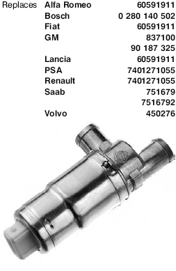

Ještě jedna lahůdka obtokový ventil BOSCH 0 280 140 502:
LUCAS FDB834
ALFA ROMEO: 60591911
CITROËN: 7401 271 055
FIAT: 60591911
LANCIA: 60591911
OPEL: 8 37 100
90 187 325
PEUGEOT: 7401 271 055
RENAULT: 74 01 271 055
SAAB: 75 16 792
751 679
Modelltypen kW (PS) ccm Bj. von - bis
ALFA ROMEO 145 (930) 1.4 i.e. 66 (90) 1351 07.94 -> 12.96
ALFA ROMEO 146 (930) 1.4 i.e. 66 (90) 1351 12.94 -> 12.96
OPEL MONZA A (22_) 2.2 E 85 (115) 2197 11.84 -> 08.86
OPEL MONZA A (22_) 2.5 E 100 (136) 2490 05.81 -> 08.86
OPEL MONZA A (22_) 2.5 E 103 (140) 2490 06.84 -> 08.86
OPEL MONZA A (22_) 3.0 GSE 132 (180) 2968 02.78 -> 08.86
OPEL MONZA A (22_) 3.0 GSE 115 (156) 2969 09.85 -> 08.86
OPEL OMEGA A (16_, 17_, 19_) 3.0 (3000) 130 (177) 2969 03.87 -> 09.90
OPEL OMEGA A Caravan (66_, 67_) 3.0 130 (177) 2969 03.87 -> 09.90
OPEL REKORD E (17_-19_, 11_, 14_, 16_) 2.2 E 85 (115) 2197 11.84 -> 08.86
OPEL REKORD E Caravan (61_, 66_, 67_) 2.2 E 85 (115) 2197 11.84 -> 08.86
OPEL SENATOR A (29_) 2.2 E 85 (115) 2197 11.84 -> 08.87
OPEL SENATOR A (29_) 2.5 E 103 (140) 2490 09.84 -> 08.87
OPEL SENATOR A (29_) 3.0 115 (156) 2969 09.85 -> 08.87
OPEL SENATOR A (29_) 3.0 E 132 (180) 2969 02.78 -> 12.86
OPEL SENATOR B (29_) 3.0 130 (177) 2969 01.88 -> 09.90
SAAB 900 I 2.0 Turbo-16 118 (160) 1985 11.85 -> 12.93
SAAB 900 I Combi Coupe 2.0 Turbo-16 118 (160) 1985 11.85 -> 06.94
SAAB 9000 2.0 -16 Turbo 129 (175) 1985 04.85 -> 12.91
SAAB 9000 2.0 -16 Turbo CD 136 (185) 1985 09.89 -> 12.98
SAAB 9000 Schrägheck 2.0 -16 92 (125) 1985 12.85 -> 12.88
SAAB 9000 Schrägheck 2.0 -16 94 (128) 1985 12.85 -> 08.88
SAAB 9000 Schrägheck 2.0 -16 Turbo 127 (172) 1985 06.89 -> 12.92
SAAB 9000 Schrägheck 2.0 -16 Turbo 129 (175) 1985 09.84 -> 12.91
SAAB 9000 Schrägheck 2.0 -16 Turbo CS 136 (185) 1985 09.88 -> 12.98
VAUXHALL SENATOR Mk II 2.5 i 103 (140) 2490 09.87 -> 10.90
VAUXHALL SENATOR Mk II 3.0 130 (177) 2969 01.88 -> 09.90
jakási ZASTAVA - YUGO 466 415 52

LUCAS FDB834
FIAT: 60591911
LANCIA: 60591911
OPEL: 8 37 100
90 187 325
SAAB: 75 16 792
751 679
