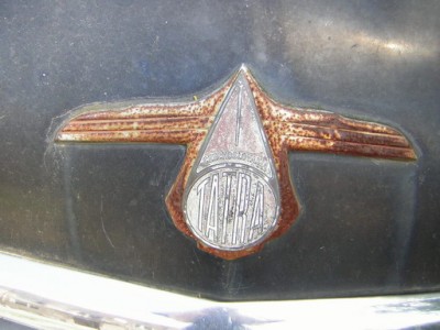

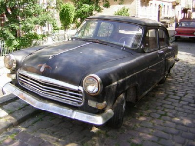

Help me to define the machine of Tatra model, in its technical documentation they state it's 600 but it doesn't look like it.
Príspevok od užívateľa Roman Maďar » 05 Feb 2007, 20:25
it is Volga Gaz23

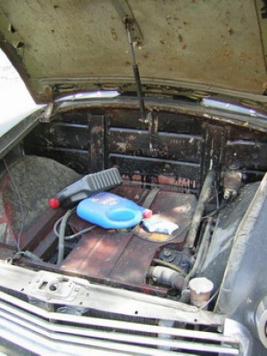

It can not be Volga, because motor is not in front.
Maybe body is from Volga, motor - from Tatra???

Great, devil in sheep´s clothes Very Happy sou you get Volga equipped with engine T603A /one carb, aircooling ON cylinders, not sucking from them lika F-H types), im not very skilled in this older ladyes, so take my info ´bout engine type not so serious. Definitly, this is not a Tatra body.

it seems to me that this car is a combination of a Volga M21 body with a Tatraplan chassis and a T603 engine.

I have not see Volga with so back stop-signal (glass) and so cabine.

I have never seen such a joint of 2 different car manufacturers. But it is definately more Volga than Tatra...

I suppose the rear flash lights are from a Moskvich 412.

Kto by si daval tolku namahu aby do nejakej volgy montoval dozadu motor z Tatry, ked uz aj ano, kto by si dal tu namahu vymienat vsetky znaky,stitky a niektore dalsie diely len koli tomu aby oklamal svoje okolie aj napriek tomu ze cele okolie vie ze je to volga? Vsimli ste si niekto toho bufika v stredovom tuneli?A este navyse- vsetky diey su v priblizne rovnakom stave, co prestavbu s posunom niekolko desiatok rokov vylucuje. Fakt neviem co si mam o tom aute mysliet. Kazdopadne ak by si niekto niekedy take nieco vysnival, doniesol Volgu k sudruhom do Koprivnice, polozil na stol kopu penazi a povedal- "spravte mi z nej Tatru" a oni by mu z toho Tatru urobili, bol by to velmi zaujimavy kusok...

Přední blikny Moskvič, Karoserie Gaz 21 okolo roku 1969 a motor štítky a další opravdu Tatra dá se dle čísel zjistit jaká ten štítek je dost dobře čitetelný. Jinak kočkopes. :lol: :lol: :lol:
Príspevok od užívateľa Karel » 06 Feb 2007, 21:31
V bývalém Sovětském Svazu byly z důvodu nedostatku automobilů dost časté tzv. ,,samodělky,,. Místní úřady k nim byly dost benevolentní a dala se tam přihlásit i auta která vznikla ze všeho co bylo zrovna po ruce. To bude zřejmě i případ tohoto vozu, protože ty úpravy vznikly zřejmě již velmi dávno. Původní Tatra vzala zřejmě za své při nehodě (nebo korozí) a tak si majitel sehnal jinou zdravou kastli (zřejmě s vadným motorem) a implantoval do ní to co bylo z Tatry použitelné. Nevím proč je tam štítek z T-600, ale jiný asi nebyl k dispozici (ostatně kdo to v Rusku pozná).
